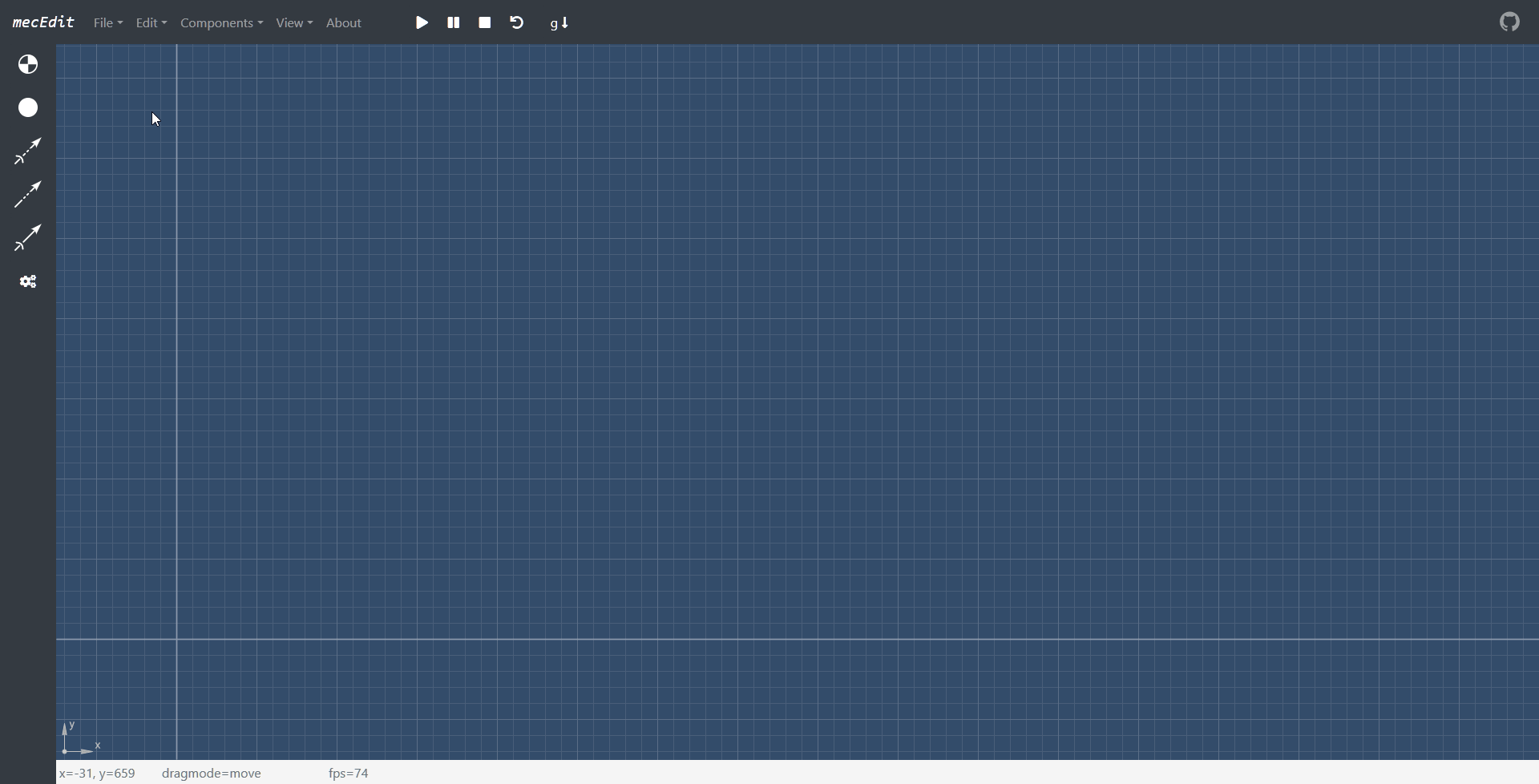

1) After starting Mechanism Creator and Editor you will see the following interface.
Mechanism Creator after the start
Figure 1 Mechanism Creator after start
Table 1, Mechanism Creator GUI
# Name Function
1
message area Context-sensitive messages and warnings that are used for communication with the user are displayed here.
2 navigation bar Contains all functionalities arranged in dropdown menus.
3 controls Control the state of the app.
4 gravity toggle Switch gravity on or off.
5 sidebar Quick access for frequently used components.
6 editor Workspace for modeling mechanisms.
7 coordinate system indicator Shows the currently used coordinate system.
8 origin Origin 0
9 status bar Shows information about the current state and mode of the editor.
10 input elements If the model has actuators, their controls are shown here.
11 chart sidebar If the model has charts with a property "canvas":Id they will be rendered on canvas elements in this sidebar.
