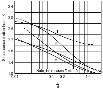

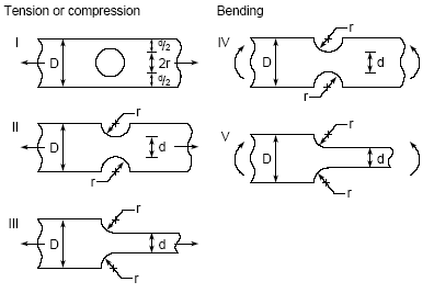

Flat plate with semicircular fillets and grooves or with holes. I, II, and III are in tension or compression; IV and V are in bending.

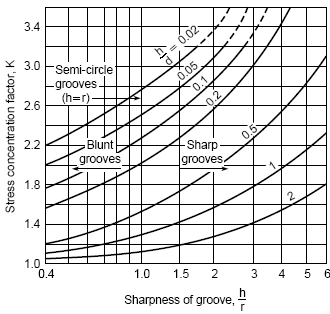

Flat plate stress concentration factors with grooves, in tension.

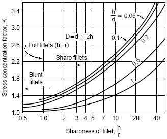

Flat plate stress concentration factors with fillets, in tension
Flat plate stress concentration factors with fillets, in tension.

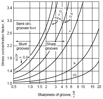

Flat plate stress concentration factors with grooves, in bending.

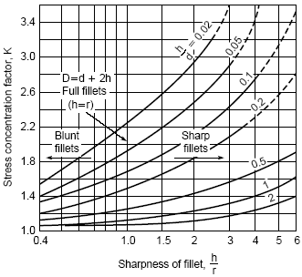

Flat plate stress concentration factors with fillets, in bending.
