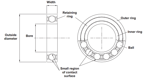

The load on a rolling contact bearing is exerted on a very small area as illustrated in Figure 1. Should the resulting contact stresses are very high and of the order of 2000 MPa. Despite very strong steels (e.g. BS 970 534 A99, AISI 52100) all bearings have a finite life and will eventually fail due to fatigue. For two groups of apparently identical bearings tested under loads P1 and P2, the respective lives L1 and L2 are related by the life equation given in Eq. 1

Contact area for a ball bearing.

The dimensions for rolling element bearings have been standardized and can be purchased as stock items from specialist manufacturers and suppliers. The selection of a bearing from a manufacturer's catalog involves consideration of the bearing load carrying capacity and the bearing geometry. For a given bearing, the load carrying capacity is given in terms of the basic dynamic load rating and the basic static load rating.
The basic dynamic load rating, C, is the constant radial load which a bearing can endure for 1 x 106 revolutions without evidence of the development of fatigue in any of the bearing components.
