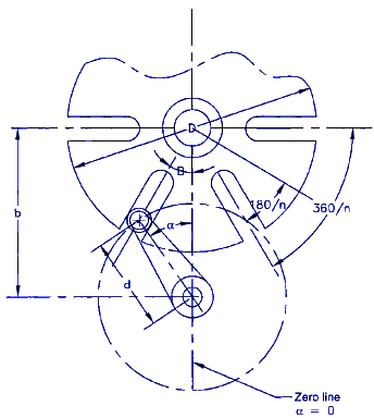

Kinematics of the External Geneva Drive. Assumed or given: a, n, d, and p.
a = crank radius of driving member
and
m = 1 / ( sin (180/n) )
n = number of slots in drive
d = roller diameter
p = constant velocity of driving crank, rpm
b = center distance = am
D = diameter of driven Geneva wheel
ω = constant angular velocity of driving crank = pπ/30 rad/sec
α = angular position of driving crank at any time (degrees)
β = angular displacement of driven member corresponding to crank angle α.
Angular Velocity
Angular Accerleration
Maximum acceleration
Max velocity
