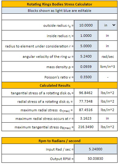

Preview: Rotating Ring Bodies Stress Calculator

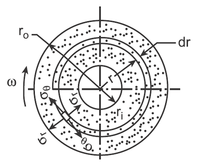

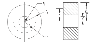

r = radius to the stress element under consideration, m (in)
ρ = mass density, kg/m3 (lbm/in3)
ω = angular velocity of the ring, rad/s
v = Poisson's ratio
ri = inside radius, m (in)
ro = outside radius, m (in)

Rotating disk of uniform thickness.
Figure 1 Rotating disk of uniform thickness.
Rotating Ring Stress
Figure 2 Simplified Rotating Ring Stress
