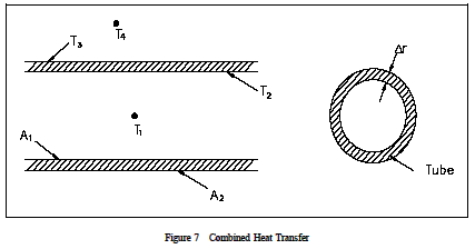

An example of this concept applied to cylindrical geometry is illustrated by Figure 7, which shows a typical combined heat transfer situation.
Combined Heat Transfer
Using the figure representing flow in a pipe, heat transfer by convection occurs between temperatures T1 and T2; heat transfer by conduction occurs between temperatures T2and T3; and heat transfer occurs by convection between temperatures T3and T4. Thus, there are three processes involved. Each has an associated heat transfer coefficient, cross-sectional area for heat transfer, and temperature difference. The basic relationships for these three processes can be expressed using Equations 2-5 and 2-9.

DTocan be expressed as the sum of the DT of the three individual processes.
Temperature Change
If the basic relationship for each process is solved for its associated temperature difference and substituted into the expression for D To above, the following relationship results.
This relationship can be modified by selecting a reference cross-sectional area Ao.
Solving for Q results in an equation in the form Solving for Q results in an equation in the form
.Solving for Q results in an equation in the form
Equation 2-10 for the overall heat transfer coefficient in cylindrical geometry is relatively difficult to work with. The equation can be simplified without losing much accuracy if the tube that is being analyzed is thin-walled, that is the tube wall thickness is small compared to the tube diameter. For a thin-walled tube, the inner surface area (A1), outer surface area (A2), and log mean surface area (A1m), are all very close to being equal. Assuming that A1, A22, and A1m are equal to each other and also equal to Ao allows us to cancel out all the area terms in the denominator of Equation 2-11.
This results in a much simpler expression that is similar to the one developed for a flat plate heat exchanger in Figure 6.
